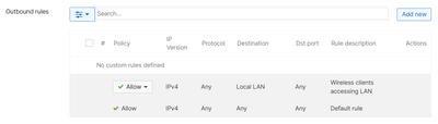

Hi Purroy,
That's exactly how it's configured. Here the screenshots:
Best Regards

EdgeFarming
Hi Alemabrahao,
Everything is configured that way .Here the screenshots:
Best Regards
