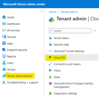

You could consider using Microsoft Cloud PKI:
https://learn.microsoft.com/en-us/mem/intune/protect/microsoft-cloud-pki-overview
This is built into Intune, but does require an extra licence.
This allows you to deploy a certificate using Intune onto every device you like.
You then configure your SSID on the Meraki side to use "Enterprise Authentication" (aka WPA2/WPA3) using local auth and certificates. Upload your Cloud PKI root CA certificate, and you are done.

Hi @PhilipDAth did you follow a guide to do this? If so can you point me in the right direction. We are struggling with the Intune bit! As we are not fully familiar with how it works.

Okay no problem.
Can I ask how you created the cert and deployed it, in intune?

You create the cert (actually 2 of them) in Intune. You download the second cert, convert it to a PEM file, and upload that into the Meraki Dashboard.
You create an Intune policy to deploy a certificate from CloudPKI to every enrolled machine.
