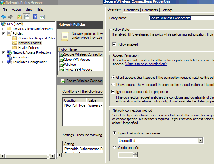

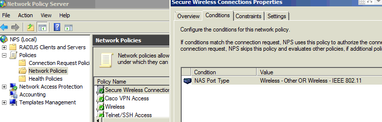

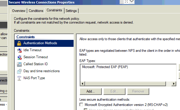

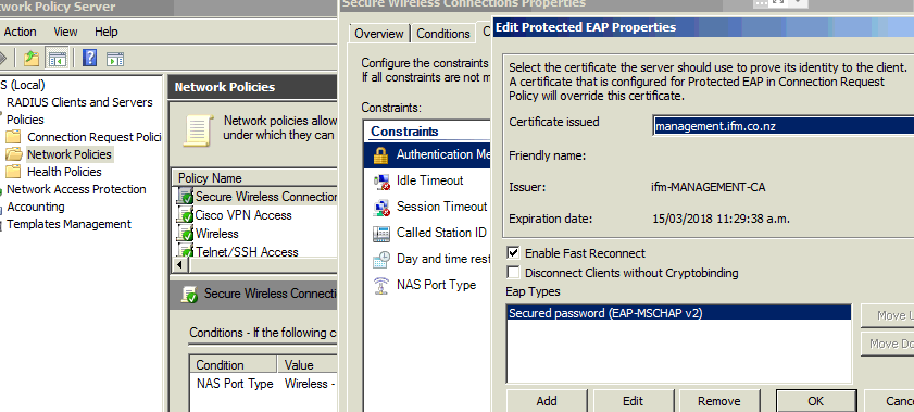

Lets check some basics (I'm assuming you are using WPA2-Enterprise mode):
  • Are you running an Enterprise CA?
  • Have you requested a certificate from that CA for the NPS server?
  • In Policies/Network Profiles:
    • On the Overview tab tick "Ignore user account dial-in properties"
    • I normally set a "Condition" that Nas-Port-Type=Wireless
      • Under "Constraints/Authentication Methods" un-tick all methods.  Add PEAP.  Edit PEAP and make sure the certificate you requested above is selected.  Under EAP-Types make sure only EAP-MSCHAPv2 is selected.
