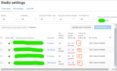

We are installing MR. 56 APs for a high ceiling room (11 meters H), that required maximizing transmit power as much as possible. However, the actual power (~13 dBm) were not reflected as setting (target power: 27 - 29 dBm) as picture below.
Does any one experienced the same issue and can resolved?

Take a look at the max power limitations and see if any of these apply to your setup
https://documentation.meraki.com/MR/Radio_Settings/RF_Profiles#Max_Radio_Power_Limitations

After searching, it is clearer that each AP model has specific power limitation (only show when manual setting), as below:
