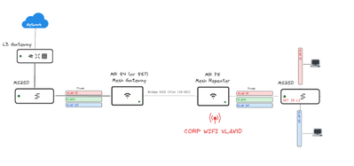

Good day everyone,
Before writing this I made sure to read offical documentation:
Extending the LAN with a Wireless Mesh Link - Cisco Meraki
We are planning following topology to  extend  our lab network:
The documentation does say that multi vlan is supported version 28 but it's not very clear to me if multi-vlan is supported on the right side of the bridge and if switch need to be L2 or L3 mode.
Thanks in advance for any feedback

With your multi-VLAN scenario at the far end, you will need a Layer 3 switch, as per this extract from the doc you referenced (see below)   Note though - you can't use the same VLANs on both sides of your Layer 3 boundary;  your VLANs on the far right would need to be different VLAN IDs / subnets - hence the need for routes on both sides.
It is possible to extend the LAN and support multiple subnets on the remote side of the bridge. However, this does require a layer 3 switch due to the nature of 802.11 frames preventing multiple VLAN IDs from traversing the wireless bridge link. The layer 3 switch will rewrite the frame and place it in the required (transit) VLAN when sending it to the wireless bridge (repeater MR)

So M. Greenman in case I need to extend 2 vlans to a remote (13m) location if clients contraints me to have same broadcast domain would this architectcure be valid?
Inspired from the most basic first example from said documentation to extend L2 vlan 😄

@noobnetwizard  based on your diagram the far side switch does not need to be layer 3. This diagram is showing multi VLAN mesh and that feature needs to be enabled by Meraki Support on your repeater AP. You only require a L3 switch on the far end when there will be more wired Meraki APs connected to it.
I have essentially the same config in my lab right now.

I haven't labbed this, but what you are describing seems to run counter to the "Extending the LAN and Configuring Network Segmentation" section where it says that allowing connectivity to any VLAN other than the one used on the wireless link "does require a layer 3 switch due to the nature of 802.11 frames preventing multiple VLAN IDs from traversing the wireless bridge link."
I can see in my console where it has the pop-up menu  for "Clients wired directly to Meraki access points" and then lists the SSIDs for the network. How have you set this up to allow for Layer 2 roaming to wired devices for multiple VLANs across one wireless link? What does support enable or setup when you engage them? This makes me wonder what other features are hidden like gnomes only to be revealed by calling Meraki support to ask for things that the documentation says are not possible.

At some point I hope the feature will be visible in the UI, but I don't control such things. Today, it's backend/device level on the repeater AP to enable trunking of the eth port and requires Support to enable it.
And to be fair the doc does state it's possible.
