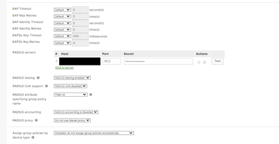

I have 802.1X configured with all my Meraki network switches and works fine.  I just changed my Meraki AP's from Pre-Shared key (PSK) configuration to Enterprise with "My RADIUS server" and will not connect.

Have you configured your RADIUS server on the SSID, other than just selecting Enterprise with Radius as authentication method?
rhamersley
Yes and and the Access Points show green also.   If it was not configured correctly I would see a problem with the AP's.

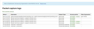

You can also capture traffic leaving the AP on the wired port and filter on port 1812 to see the conversation between the AP and the radius server.  You get at treasure trove of information like the AV pairs exchanged.

In dashboard you can go to Network wide -> packet capture.
Then select for Access Points.
Then tag the correct access point.
Then below that you have the option to download the packet capture or view it on screen (download gives the option to view it in wireshark which is better).  And a text box for CAPTURE filters (not display filters).
In that box just put the filter: port 1812 and start capturing right before a client connects to the AP on the radius SSID and see the exchange of messages between AP and Radius server.
rhamersley
Appreciate the assistance....Where is the file created after my packet capture...
I started and stopped it.
rhamersley
I guess the better question is how do I download this file to my Wireshark??
