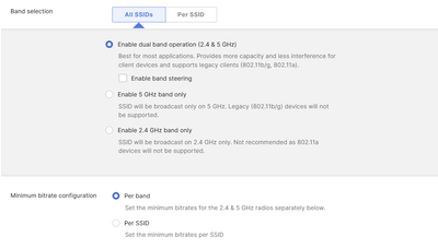

We recently purchased and installed a bunch of these to replace MR36s but I am not seeing anywhere that I can enable 6Ghz band on them for Wifi6e.  Nothing in RF Profiles and ax is not disabled.  I looked at Meraki's documentation here and I don't even have an option for Flex:   https://documentation.meraki.com/Wireless/Install_and_Get_Started/Installation_Guides/CW9166_Install...
I don't have any of the options below:
RF Profile on our end:

These APs are in India and running MR 31.1.8.  Does every SSID being broadcasted needs to be WPA3?  Cause our primary ones are already WPA3 only but we have a couple hidden ones that are set to WPA2 which I don't care for 6e on them.
Ok since they are India I guess that is why.
Only one needs to be configured for WPA3.

Google is telling me that 6 GHz isn't allowed in India yet, but it is close.
https://wifinowglobal.com/news-blog/india-delicenses-lower-6-ghz-band-unleashes-massive-wi-fi-equipm...
mak2018
Yeah that is exactly why I don't have that option even though the APs support it.
