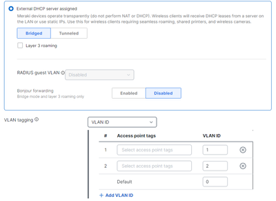

Multiple Bldgs/VLANS. Is it possible to have common SSID/Password between them and assign default VLAN to either through AP or group policy (not SSID)? Or do we need to have 2 unique SSID for both? There is no overlapping APs between 2 buildings.
For example.
BLDG1, VLAN1, SSID Prism
BLDG2, VLAN2, SSID Prism

You can assign VLAN per AP (using TAGs) or via Group Policy to clients.
https://documentation.meraki.com/MR/Client_Addressing_and_Bridging/VLAN_Tagging

Pablo. I tried to implement but when changing between tagged APs, it would not pull DHCP even though isolation and LAN/WLAN isolation was off. I see that this was an issue others had. Ideas?

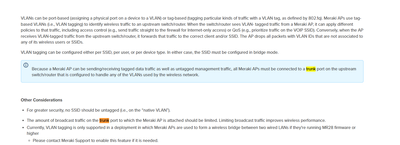

For this to work, you need to configure the Switch Port on which the AP is located as a trunk.

There are two options.
If all the APs are in a single network you can tag the APs, and then assign a VLAN based on tag. You can see it in the SSID settings.
