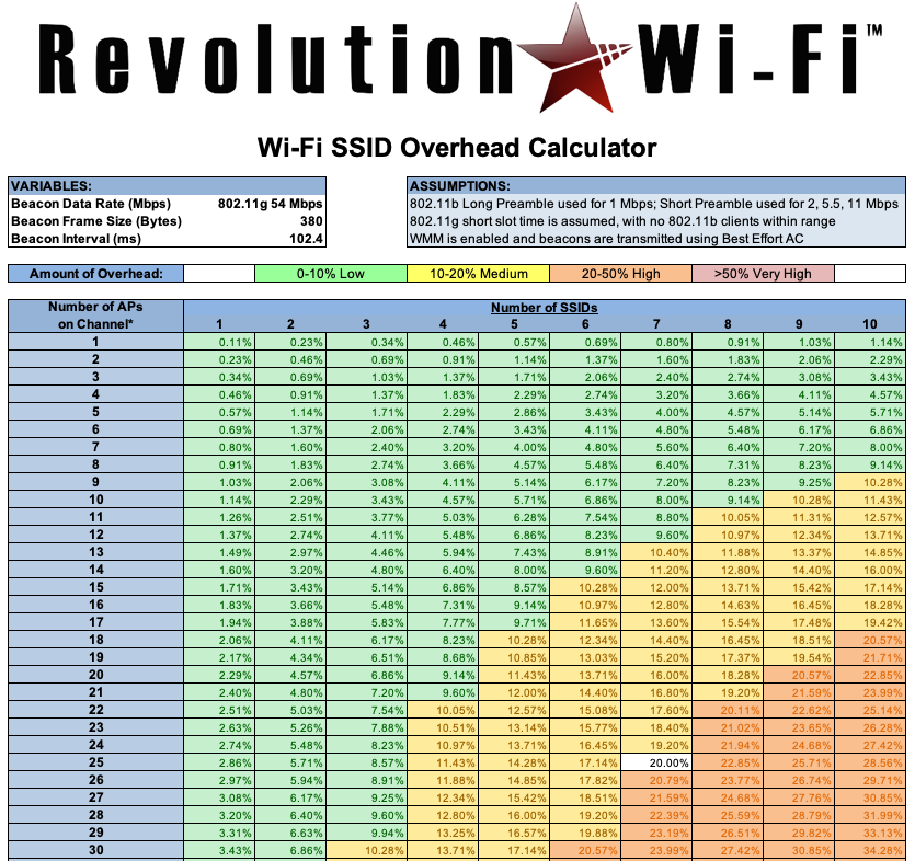

A minor point of clarification to the general rule of thumb: the formula depends on multiple variables:
- The number of SSIDs
- The number of APs on that channel (each SSID on that channel counts as an AP)
- The beacon data rate
If you are inclined to engineer a little further, adjusting any of the three can provide relief for the other two. Eliminating support for 802.11b data rates can free up a significant amount of RF duty cycle on that channel. The table on the website below paints a grim picture, but please note that it references 802.11b 1Mbps data rates. Downloading the spreadsheet and changing it to 802.11g 12 Mbps yields a radically different result.
http://www.revolutionwifi.net/revolutionwifi/p/ssid-overhead-calculator.html
And to build on @Jon_Hartman 's excellent answer, these don't even have to be your APs. They can be APs from other nearby offices.
