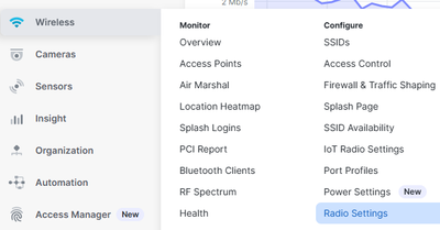

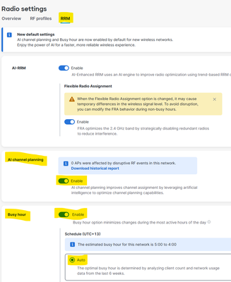

Try enabling these two settings:
You want the system to avoid changing the channels while they are in use, as it requires clients to be good enough to roam, otherwise they'll get cut off.
https://documentation.meraki.com/Wireless/Operate_and_Maintain/User_Guides/Radio_Settings/AI_-_RRM#A...

There both enabled... Talking to support there looks to be a bug, as they are not doing what they should be doing. But with them being EOL, I'm not sure there will be a fix.
I've set some to manual, to try and space out the channels, so hopefully that works.
