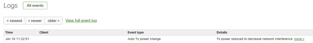

Recently we have been struggling with an issue ( or what seems to be an issue ). Our APs are always ( 10-15 times a day ) increasing and decreasing Auto TX power ( see below ).
My question :  When the Auto Tx power change occurs , are clients kicked from the AP ? People are complaining that they must rejoin the Wifi atleast 8-10 times a day.

No, the clients are not kicked off as part of the TxPower adjustment process, but if they are on the edge of coverage they could theoretically find themselves out of it if the SNR drops below their threshold. As such they would need to find a new AP to connect to. It is possible that is what is happening and there are issue with either your coverage and/or your roaming. I would recommend looking at both. As for the constant flux in AP TxPower, that makes me think your AP layout and coverage is not balanced. Have you had a Site Survey performed?

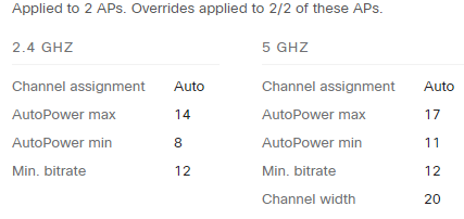

@jdsilva - I was reading up on the Auto TX Power change discussion to which I'm replying... we recently experienced some connectivity issues during our company's Town Hall meeting (with lots of users and their devices crammed into the same conference room). Twice, the Video Conferencing session was disconnected and users reported temporarily being unable to connect to Wi-Fi. When I looked through the logs for the AP in that Conference Room I noticed that there were 'Auto Tx power change'[s] occurring at the same times connectivity issues were experienced.
I have since created a new static profile for our 2 AP's which live in Conference Rooms  and following Meraki's recommended default for Conference Rooms, [see below] but I noticed your comment on the client balancing setting. I was curious on the behavior you've experienced with this setting, and if you'd recommend disabling it for the conference room environment/scenario I described.
