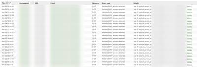

I'm testing MR30.6 in a Lab. Since the upgrade , my event logs are flooded with :
Vlans are configured on the MX , and the MX relays the DHCP requests to multiple DHCP servers , so of course multiple DHCP responses will be received.

Anyone experiencing the same thing ? That doesn't make any sense to me... Clients connected to the MX or the MS on the same vlan do not generate these logs despite receiving multiple dhcp offers.

This is the reply I got :
After discussions with a few different members of my team that worked on the original bug report, the reason why the fixes weren't working for us here is because I originally misinterpreted what the report sought to fix. The original report was related to seeing the Multiple DHCP servers detected in the event log when only one dhcp server was specified as dhcp relay. In short, activating any DHCP relay at all even with one relay agent upstream would trigger this and that behavior specifically was what was fixed*. With that said, it was explained to me that since more than 1 DHCP server is specified as a relay for the same vlan upstream in this situation, then the Multiple DHCP servers detected alert is actually true in this case since clients could receive offers from two separate servers, and therefore the DHCP server detection feature is functioning as intended in this case.
