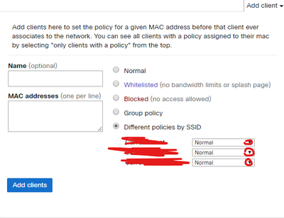

I am building out a new network to replace an existing wireless network that used MAC filtering for clients. The old setup consisted of a pre-shared key and MAC list.
I see that in dashboard, you can go to organization-->clients and add a client to the network, but after I put in the MAC and a name, and hit save, it simply says "changes saved" --I don't see that MAC listed anywhere. Will it not show up until the client actually connects?
Also, to do MAC filtering do I have to use a Radius server? Or can I use the old pre-shared key with MAC filtering?
MAC addresses you add as clients don't show up until the client has connected, and then you have to display the list of clients for the time period the client would have been connected in.

You can create a "group policy" that way you have a list of MAC addresses you import plus make your own rules and blocks for that policy. You won't need a RADIUS server.
Enthusiast
Silas1066
I see the group policy creation screen, but don't see anywhere to add a list of MAC addresses
kYutobi
You add them as if you were adding a wireless client. Select the dropdown and assign policy.

Silas1066
I have the SSID and MAC working (assigned a policy to my laptop), but I am a little unclear on the firewall blocking
so I should go into the SSID and select layer 3 firewall rules and set the default action to block any to local LAN (or any) and simply leave it as that?
wouldn't this block access to everything regardless of allowed MACs? Or does the individual group policy override that?
kYutobi
@Silas1066 The group policy will override it but by default it will block everything else that's doesn't have one.
Enthusiast
Silas1066
yes, it looks like it is working. Unless the client is listed with a MAC association and policy, they get "packet filtered" errors when trying to do anything on the network--so it looks like they are blocked.
thanks for your help. This was a bit counter-intuitive, but now it makes sense
