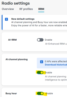

A general tip, go to "RF Profiles":
https://documentation.meraki.com/Wireless/Operate_and_Maintain/User_Guides/Radio_Settings/RF_Profile...
Create a new profile.  The most common one I use is "Open Office Profile".
This uses sensible settings.  Apply this profile to all your APs.
On the RRM tab enable "AI channel planning" and "Busy hour".
