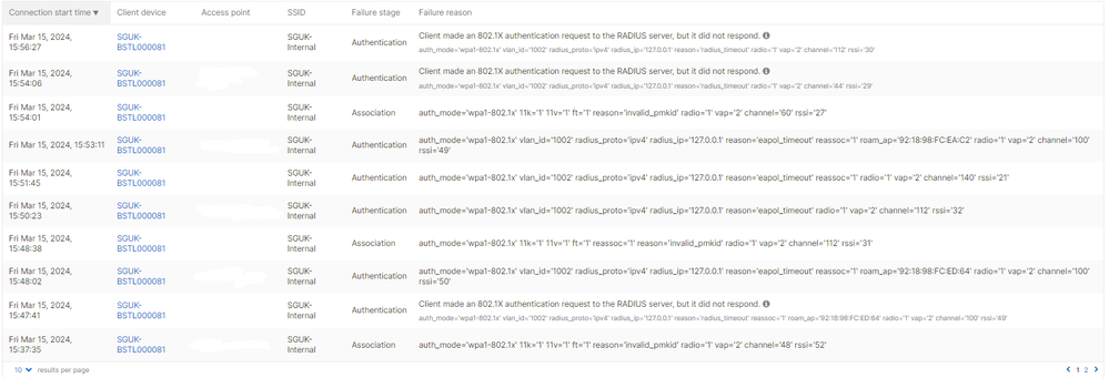

Hello all,
Having trouble with our local Auth where users will have random drop outs when one in a static location or moving around the building. from the logs and test we have done it looks like the AP's radius isn't responding to the clients. please see below Screenshot 2024-03-18 085615.png

Hi Daniel,
how is the SSID encryption configured?
Are you using "WPA1 and WPA2" or "WPA2 only"?
I am asking because according to your screenshot, your clients are trying to connect with WPA1.
We have observed the same messages in log with iPhones, which always try to connect with WPA3 on our local auth SSID.

SSID is configured with WPA 2, Ill run some more tests on more devices see if WPA 1 is being used when it shouldn't.
Thanks for the spot !
