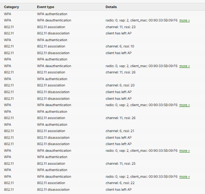

We're running on a weird issue with a new cordless voip phone.
Despite it seems to be correctly connected to our network, it keeps switching back and forth to different APs.
When we tried to have it isolated with only 1 possible ap it can connect, it still drop the connection for a few seconds every other minute. I attached a screenshot with an example of 2 minutes of the event log for the device.
This is the only device having this problem. We do have other voip phones on the same SSID that never had any issues, although they are different, older models.

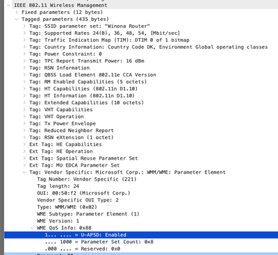

Do a PCAP and check the Beacon Frame. IE 221 should tell you that it's enabled.
