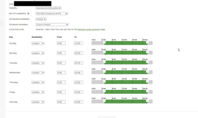

So, trying to figure this out. I have 6 Different  Identity PSK without Radius Group Policies and If I say set the "iot" PSK Group Policy to be disabled on Fridays, but the Parent SSID "Production" is set to be working from 8 AM to 10 PM.
It doesn't appear the sub group policies schedule have any effect on the parent SSID Access Control settings.
The above has no affect and the iot PSK still works.

In fact, I don't understand your configuration, where is the configuration of the Parent SSID "Production"? Apparently, your configuration is correct.
MrRoboto2338
Production SSID, it seems to override my Group Policy Settings

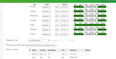

Actually, I have some IOT devices, along with some other devices on an Identity without Radius SSID that I want to run 24/7. The other 5 PSK on that SSID scheduled to run 8 AM to 5 PM. So basically I want a policy for the IOT that is different than the rest of the SSID.

As @RaphaelL said In your example, you removed Friday from the schedule. The PSK will still be active, but without the GP.

In theory it should work.  https://documentation.meraki.com/General_Administration/Cross-Platform_Content/Creating_and_Applying...
Setting a schedule will enforce or not settings during that period.
In your example , you removed Friday from the schedule. The PSK will still be active , but without the GP.
The example from the documentation is pretty clear.
Edit : Look at 'Scheduling Examples'

So I have the IOT Group Policy disabled on Friday, the SSID Policy above it is still available and on during work day. However, when I type in the IOT PSK on a device, I get on no problem. Shouldn't it simply not work?
Nope,  you are not scheduling when the SSID will work or not. GP schedule is not for this function.
However, you can create a policy like this, as mentioned by @RaphaelL
RaphaelL
That will work. You have to schedule a L3 firewall rule to block trafic. This will prevent IOT from using the SSID on friday. Look at the examples provided.
