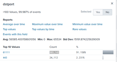

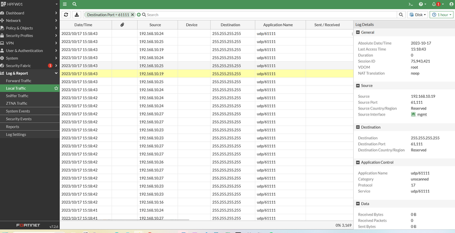

Hello! Can anyone can assist me as to why our AP's are flooding our network with broadcast traffic over Client Balancing port 61111?
Over 985,000 a day in deny logs from our Forigate firewall. 192.168.10.x(AP's LAN IP) -> 255.255.255.255
The AP's are on a trunked VLAN.This issue has been going on for as long as we know, it was caught because we recently started using Splunk. We have experienced issues with client devices disconnecting somewhat randomly when signal strength is good.

Still seems like a heck of a lot of broadcast traffic for Cisco AP's to be sending out. The firewall rightly blocks it as the traffic isn't meant for it but the sheer amount of broadcast... something must be off. In your experience do the AP's send out this much 61111 broadcast traffic or do they identify the neighboring AP's in it's local DB and quiet down?
Edit: This is outside my current network knowledge unfortunately. I need to review how broadcast frames are sent from a device, in this case 192.168.10.23 when it's part of a trunk. If it sends broadcast to all VLAN's it has access to on the trunk or not... Because over 102 broadcast frames per minute from a single AP is not normal.
