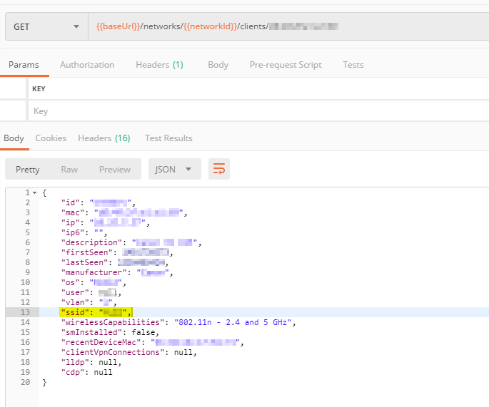

Actually when you fetch a client's details you do get the SSID:
CiscoUser
Thanks a lot !
Wasn't aware of this path, just what I needed ^^
