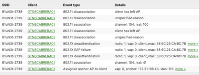

I have the following problem, I have 4 Ap's that have configured an SSID for 802.1X with custom RADIUS, the problem is that the users do not last more than 1 minute connected and the connection drops, reviewing the logs I noticed the following:
The "client has left AP" message catches my attention, this message is repeated for any user who connects.
Could someone help me to solve the problem, please?

Yes, but the messages persist and I am concerned when more users are connected and the problems are greater.
Try to change the Radius timeout on your SSIDs, by default It's 1 second, and change it for 10.
by the way, I noticed that the client Is receiving RSSI 100, It means that there is not a good signal.
