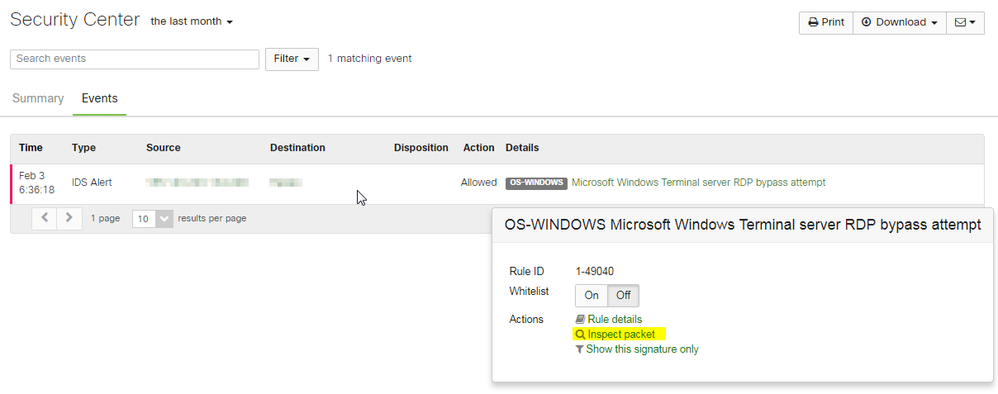

From the security center you should be able to get more details, you actually have access to the packet:
Thanks for that I didn't realize that you got that extra option under the events tab - thank you for that.
8ccd32475fa16ffddb643b6c52c6f36761b55ef2.info. IN A
This is the info I got in the packet - will have a crack at decoding it tomorrow, as not something I have done before.
