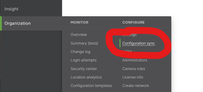

There is another option - a very old, half broken feature called Configuration Sync.
https://documentation.meraki.com/General_Administration/Organizations_and_Networks/Cloning_Networks_...
You would need to experiment, but it would probably work best if you create a non-combined wireless network for each site.  Then you can have a "master" network, and use configuration sync to copy the settings to all the other networks.  Considering your current deployment, this might not have any downsides - but templates would be nicer.
