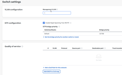

spanning tree on meraki 9300L switch :

Please note: C9K/MS390 runs single instance (0), single region (region1), and single revision (revision 1) MSTP. This is essentially Rapid Spanning-Tree. Please make sure for interoperability with any other non-Meraki platforms, to either run Rapid Spanning-tree or MSTP (not PVST or any iteration, nor any other vendor specific STP implementation). This will ensure that there are no issues with compatibility and functionality.
https://documentation.meraki.com/MS/Port_and_VLAN_Configuration/Configuring_Spanning_Tree_on_Meraki_...)
