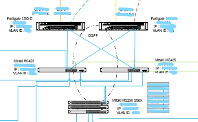

Providing the LLD below.

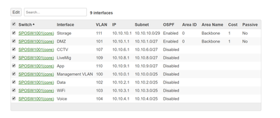

On MS425 i have created vlans as below.
on MS250( Access Sw) i have made port 40 accessing Vlan 101 and port 41 accessing vlan 102 and connected laptops on each port. laptop "X" connected on port 40 accessing vlan 101 laptop ip  is of same subnet of Vlan 101 interfaace and latop 2 connected on port 41 Vlan 102 laptop ip of same subnet of Vlan 102 and gateway of latop is the interface IP on Vlan.

youll then want to run OSPF between the MS425’s and MS250’s.
so to answer your question, surely the layer 3 gateway/domain will terminate on the MS250’s which will natively perform inter-vlan routing as long as no ACLs are configured.

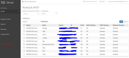

Vlan 101 & 102 are in MS 425.( all the vlans are on ms425 primary and other is Warm spare)
Do you mean I have to enable OSPF in VLANs as below?
MRCUR
Do you have VLAN's 101 & 102 allowed on your uplink from the 250's to the 425's? All of the inter-VLAN routing should be happing on the 425's right now.

Agreed on the OSPF. There is not really a need to run it here, although the original network diagram included it. It is very simple to run OSPF between Meraki devices, but it's not needed and the MS425's can certainly handle the routing.
