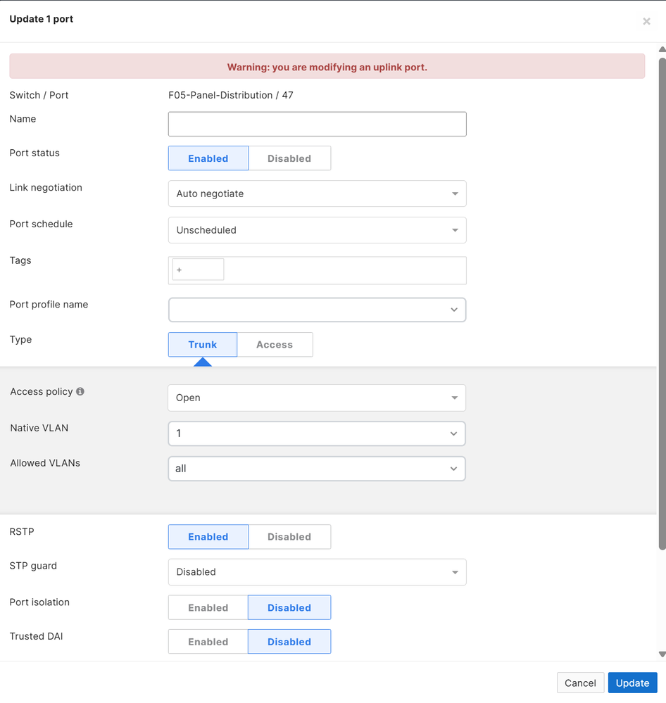

Can anyone help, in my case, when connecting the Unify switch from the Meraki switch, there is a loop and the internet connection is slow and sometimes in the Dashboard monitor for Meraki, there is a Misconfigured DNS and the connection is intermittent.

The following is a display of the port settings from the Core Switch to the Distribution Switch.Screenshot 2025-10-14 005330.png
And what about the STP priority? This looks like an STP problem to me. Probably when you connect this switch there is a new STP election for the network?
Configure the ports on each switch, that are used to connect to the other switch, to be trunk ports using a native VLAN1 of 1.  Make whatever other changes are required to make this config valid.
