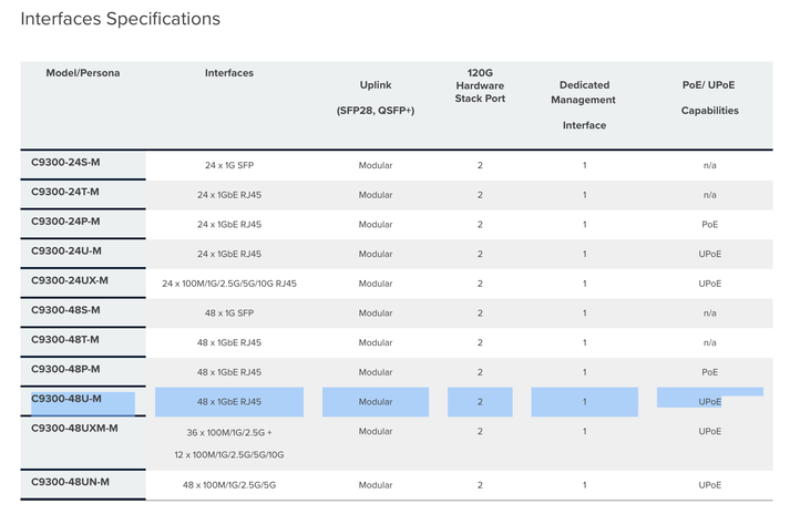

The C9300-48U-M has hardware stacking ports for switch stacking.
You would need the modular uplink for SFP, SFP+ or QSFP connectivity as the switch they have recommended has 48 x 1GbE RJ45 ports.
Catalyst 9300-M Datasheet
