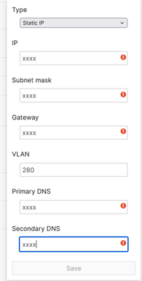

Here is a fictive image. Let's say that I tag my switch in VLAN 280 with an uplink trunk port configured as native VLAN 999 but VLAN 280 is allowed on that port. The device should work with static IP assigned?
Because for now, if the uplink native VLAN is on 280, the switch is going to work with DHCP, getting an IP on that VLAN and reaching Meraki Cloud without any problem.
RWelch
VLAN 999 is the native VLAN or the default VLAN for untagged traffic and you have specified that in the uplink (port) config so the switch is looking for untagged routable traffic via VLAN 999.
That is what the switch is expecting.
You are then configuring the static IP with VLAN 280 info which is a tagged VLAN (but the switch is still looking for native VLAN or untagged data).
