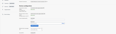

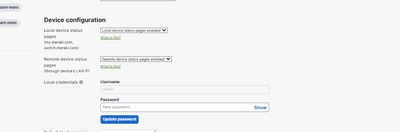

Another question: What is the password required to set up the port on the local status page of the 9300-M? I'm currently testing using the admin serial password left blank.
I always have doubts about this—if these devices were previously joined to the customer's cloud, does that mean the password is the same as the one used there? Also, I'm noticing that the interface looks different now. The password is no longer visible. I believe that in past years, it used to be possible to see it.
RWelch
If it's already connected to the dashboard, you can enter a NEW password (show if necessary) then select Update Password.
athan1234
A model citizen
It seems to be blank, but I believe that even if you change the password, it always appears blank and you can’t see the password in this new version. I just believe that — I’m not sure
so  I tested connecting using the admin serial number without a password — nothing happened
RWelch
For the other question - you might have already read this?
MR devices running MR 32+ firmware, MX devices running MX 19+ firmware, MS devices running MS 17+ firmware and MS390/Catalyst devices running CS(17+) or IOS-XE 17.15+ firmware will use the username admin and the password will be the serial number (Cloud ID) of the device (upper case letters and dashes).
All devices running other firmware versions will use the serial number (Cloud ID) of the device (upper case letters and dashes) as the username with no password.
Using the Cisco Meraki Device Local Status Page
RWelch
Accessing Local Status Page Cisco/Meraki C9300 Switch courtesy of @MaxMartini
