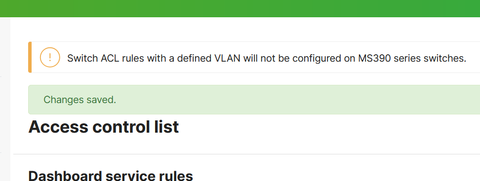

I was about to plan an install for a customer and came across this gem. This customer has probably 950+ individual rules (which is a different issue to deal with) and this creates a hurdle. Has this been noted anywhere as a fix in future firmware releases?

It is noted in the configuration guide.
Note: The VLAN qualifier is not supported on the MS390. For the MS390, ACL rules with non-empty VLAN fields will be ignored.
https://documentation.meraki.com/MS/Layer_3_Switching/Configuring_ACLs#Add_a_Rule
