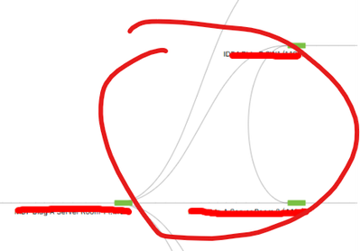

Irin04
These two switch ports are not connected . One of them has been shut down, but it’s still showing up in the topology. That might be the cause of the issue, but I’m not sure how to resolve it.

Can you share a snapshot of your topology?
Network-wide > Monitor > Topology
Irin04
RWelch
Do you have LoopGuard set here (both sides or ends)?  Or is this where you are having the loop?
I believe it is one of these switches, correct? Check if the port is actually configured to be down, otherwise disconnect the port physically.
But if the ports are not down this is actually the expected behavior.
