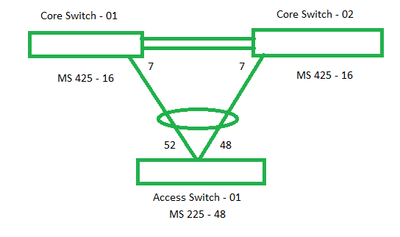

We have two MS 425 - 16 Core Switches and One MS 225 - 48 Access Switch. Both Core Switches are Stacked together.
Our requirement is port need to be aggregated for redundancy.
I will explain about how switches are connected each other in below :
Core SW-01/7 connected to Access SW-01/52 through 10Gbps SFP
Core SW-02/7 connected to Access SW-01/48 through SFP Module Meraki - 1000BASE-T: 1.3 Gbps ( Part 600-22100 )
What we are done here, We aggregated the Port 48 & 52 in Access SW-01.
In Access SW-01 Port 48 showing a message with Port running LACP and LACP has disabled this port.
I think aggregating the SFP/Copper port & different speed is not good practice.
And one more thing RSTP has been enabled on all ports.
Does RSTP and LACP work together.
Instead of this suggest a best practice for this network.

Both ports must be negotiated at the same speed.
You can't mix 1 and 10 Gig inside a port-channel.
Since you have MS225, why not use 2 10 Gbps links?
If the MS225 is in the same rack as one of the MS425's you are better off using a twinax cable to cut costs instead of trying your luck with copper ports.
