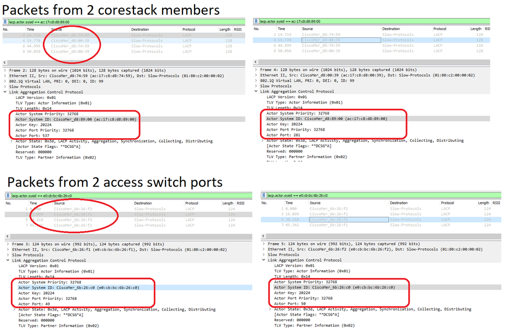

GIdenJoe
Each member port of a bundle must send LACP information where the actor System ID is identical between both ports.
If one member fails it will not be added to the bundle.
In above pictures I have taken an lacp packet capture between a meraki core switch stack (where two different stack members are downlinked in the bundle) and the access switch which is a single switch where port 49 and 50 are uplinked and bundled in a port-channel.
So on each side both ports send LACPDU's with the same ACTOR ID but a different ACTOR PORT ID for it's own system and the peer ACTOR of the other side.
If you capture both switchports leading to the server you have 100% proof that the Windows host is not behaving if you cannot see any LACPDU's on the second port.
I hope this helps.
