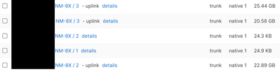

I have use Meraki Dashboard API to manage the devices, but some device use NM-8X module.
during I use  
when I update the 'NM-8X/4' it will update port 4
serial_num = 'XXXXXXXX'
portID = 'NM-8X/4'
dashboard = DashboardAPI(api_key)
try:
response = dashboard.switch.getDeviceSwitchPort(
serial_num,portID
print(response)
and try to get all of the ports  the ports on NM won`t be listed.
SN='XXXXXXXXX'
try:
# try to collect Alerts Information
response = dashboard.switch.getDeviceSwitchPorts(
SN
How to fix it.
