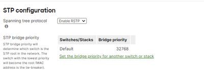

currently, this is all we have in the meraki dashboard

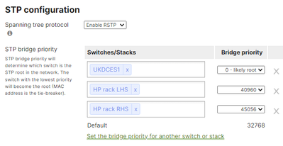

cmr
@JustinGA I think the 2960s might all have a priority of 32768 as well.  Personally I would change the primary Nexus to have a priority of 0 and set the MSs to more than 32768.  Below are examples of one of our (all MS) sites and one with a Catalyst core (which has 0 as the priority):
