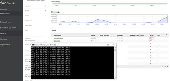

I've done that here with two switchports.
They are set as access ports tagging VLAN 500.

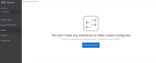

As you can see, no L3 interface for that VLAN exists on the switch (or anywhere else in the network in this circumstance)
