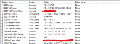

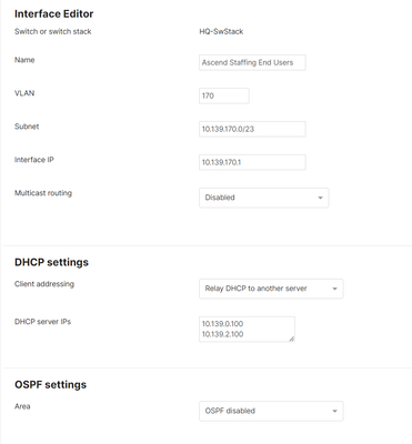

We recently had an issue with DHCP exhaustion. It's time to size up. I've gone into my DC and set up a Scope, which i more or less cloned from an existing(working) scope, and adjusted the router
in our infrastructure we have a layer 3 switch stack that we run our DHCP through

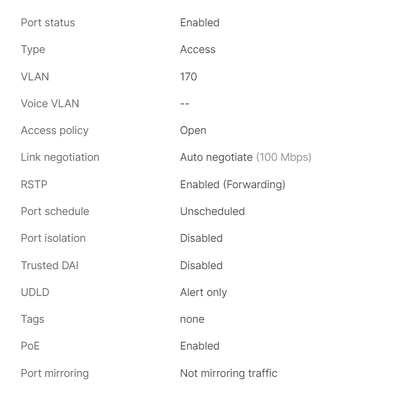

and I've adjusted the port that i'm testing on with the vlan that corresponds
can you guys give me some guidance, let me know what I might be missing here

The configuration seems to be ok. Did you perform a packet capture?
