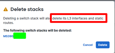

Hello,
We have a stack of 3 Meraki switches.
Two switches should be removed from the stack and the last switch should be converted to standalone switch.
What is the approach to convert a 3 member stack to just one single switch without loosing the config of that last switch?

So basically you have to delete the stack and the switches are automatically converted to standalone switches and configuration will stay the same?
GIdenJoe
Usually the port config remains on the switch as long as the switch is in the same dashboard network.
You'll have to completely remove the stack and recreate it using the remaining members.
Don't forget to remove the stacking links on those members.
