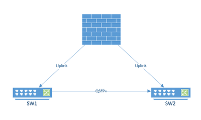

Here's what we'd be looking to setup (arrow for the QSFP+ can be disregarded but just representing the link). I'm more so referring to the time between it takes to release the QSFP+ as the uplink and failover to its individual uplink.
Prefect, if whatever is below the switches has a connection to each one of them, I believe it is enough to not have unavailability in the case of scheduled maintenance.
