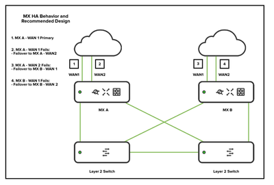

nicdc01
Hey;
Interesting connection you have there.
I would read up more on this article.
For this to work you would need VRRP traffic to pass through from one MX to another.
From your Diagram looks like you would need another connection between Site A's firewall to SiteB's Core Switch and vice versa for the recommended setup.
That being said for each Site on the Management VLAN; Security & SD-WAN > DHCP; Manually set the IP addresses for the core switches respectively.
