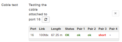

ronnieshih
To ALL and EVERYONE using Meraki cable testing feature on switch ports, I got confirmation from Meraki support today that this is a KNOWN ISSUE/BUG and development knows about it.  I have been correct all along using physical cable tester showing all pairs are sound, but the Meraki cable test is incorrect showing pair 3 as "short" or "open" when tested against devices connected at 100Mbps or 10Mbps.
Case closed, until Meraki fixes this.

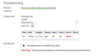

Just cable tested a non PoE device running at 100Mbps on an MS210 with 14.24, pair 3 shows open (which technically is correct):
Tested a 100Mbps connection on an MS225 with 14.22, pair 3 still shows short there:
KRobert
Head in the Cloud
Thanks @cmr . Anyone have a response from support? I can also confirm that all of the 100Mbps devices on MS210 with 12.28.1 have pair 3 showing a "short"

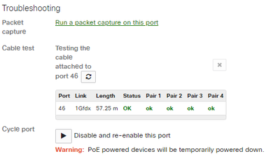

While all of the 1Gbps links show all pairs as "ok"
