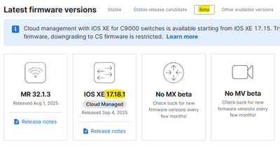

I suggest you open a support case.
17.18.1 is listed as a beta software release.

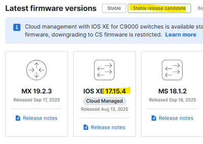

Can you drop back to a stable release candidate?
