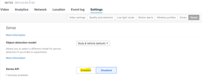

Hello members,
We recently enabled sense and custom cv on one of our cameras. Post deploying tf model, I want to understand few things about webhooks.
1. it appears webhooks needs to be enabled/added at network alert level - how would we make sure that its only listening or receiving events from specific camera on which sense is enabled?
2. In response to webhook, how to make sure it responds back with positioning of objects and does it include snapshot link?
3. How to set the frequency or occurence at which webhook will be called with data?
