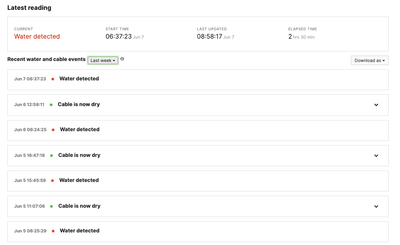

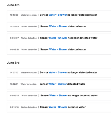

@KRobert... I have actually been trying to test this scenario for the last 18 months or so and it has been pretty consistant.  I have had a MT12 with the cable ran into my shower so that I can show when it detects water but if you notice it does take some time to NO LONGER detect water by the examples below...  Theoretically for you, this could work but it will not be immediate as I have seen upwards of 4-5 hours after turning the shower off before the sensor no longer detects.  But as @Ryan_Miles is accurate as the MT12 is primarily for the use case to detect water... not the absence of it.  I have also tried this in the back of my toilet tank (THE BACK PART) to see if it could be useful to show that after a flush it could show some data around no water being in the back tank but sure enough it just never has enough time to dry and thus always shows as water detected.  But the big thing here is that you will never be immediately notified if that tank is empty as it would take time for the sensor to dry.
