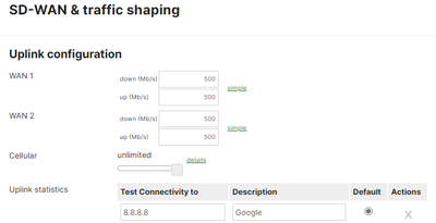

One of the easiest options here would be: how is your "Uplink Bandwidth" set up under "SD-WAN and Traffic Shaping"?
