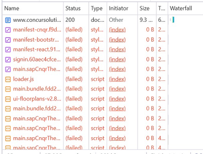

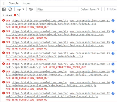

Browser network logs are showing that scripts are being blocked when the page is trying load.

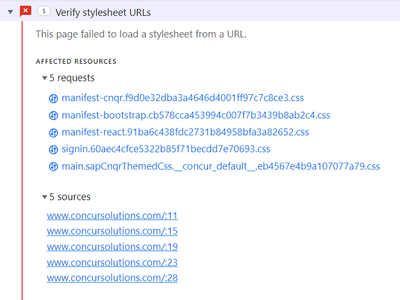

My guess is not that page directly, but content from another site referenced by that page is blocked.
I used Chrome developer tools, and this is the domains that are used:
Try whitelisting those - or running them through the content filter lookup tool to see which URL is being blocked.
Citroen
Hey, None of the domains in your screenshot are being blocked. When I inspected the page in Chrome I am see that the CSS and JS files hosted on concursolutions.com have a "failed" status. Not sure how to "allow" these.
