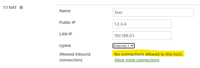

I was confused because the question was about inside-out NAT and outside-in 1:1 NAT.
They are not the same thing.
If you define a 1:1 NAT for inbound access - the MX also uses that same 1:1 NAT for all outbound access as well.
It is a "special exception".  I'm not sure it is even documented.

When you create a 1:1 NAT it defaults to blocking all inbound access - it effectively acts solely as an outbound NAT.
