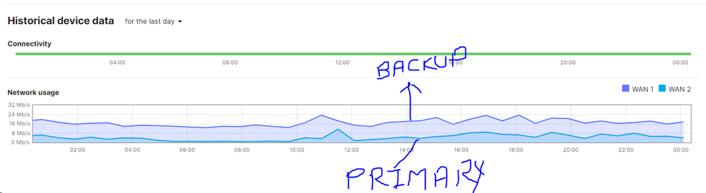

I performed the failover to test the ISP performance from secondary to primary. Now, the secondary ISP has become primary. However, I am noticing that the majority of the traffic is still going through the secondary, which was primary earlier. Load balancing is already enabled."

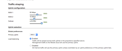

The MX can be configured to use both of its uplinks for load balancing. When load balancing is enabled under Security & SD-WAN > Configure > SD-WAN & Traffic shaping, traffic flows will be distributed between the two uplinks. The load distribution is based on the WAN 1 and WAN 2 throughput configured under Uplink configuration, such that the uplink with more throughput will distribute more flows.
In the example below, WAN 1 is configured to pass 50Mb/s, and WAN 2 is configured to pass 10Mb/s. Since the download speed ratio is 5/1, for every five flows sent over WAN 1, a single flow will be sent over WAN 2:

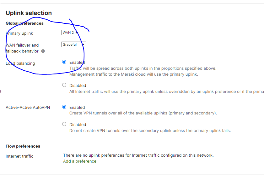

I just did that graceful failover by going to below settings so that's mean - Primary ISP which is now secondary are giving more throughput
When load balancing is enabled traffic flows will be distributed between the two uplinks. The load distribution is based on the WAN 1 and WAN 2 throughput configured under Uplink configuration, such that the uplink with more throughput will distribute more flows.
My suggestion is to disable load balancing to test.

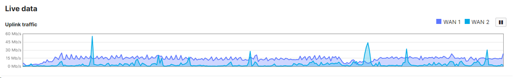

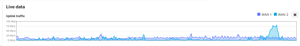

I have disabled the load balancing however why do see the spike on secondary link - WAN 2 is a primary uplink right now

If you have VPN traffic configured to use WAN 2, this may cause an increase in traffic. Could you check your SD-WAN policy settings?
What about Flow preferences > Internet Traffic Configuration?
AnkitSharma1
Flow has nothing here
since all users are in office so I see WAN 2 is being utilized more
So it's ok, you said that WAN 2 is configured as primary uplink.
What's the problem?
AnkitSharma1
Now there is no problem. I just came in and found that. Most of traffic going through WAN2 so I am good.. may be it takes some time to see the changes or verify in operations time.

If you want immediate failback and don't care if existing connections are torn down change the "fallback behaviour" to immediate.

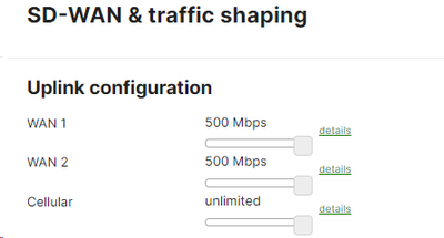

AnkitSharma1
I have not configured the uplink configuration here
its default
