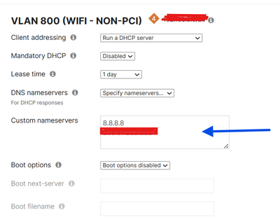

We have been trying to update the name server for VLANs using Python through the API but have been getting errors or issues
We can update using the GUI without issue but the idea is to do this in mass (we cannot use templates)
the setting is under Security & SD WAN  > Configure > DHCP

Dan_s_97
Thank you all
final working code for anyone trying to do the same in future
