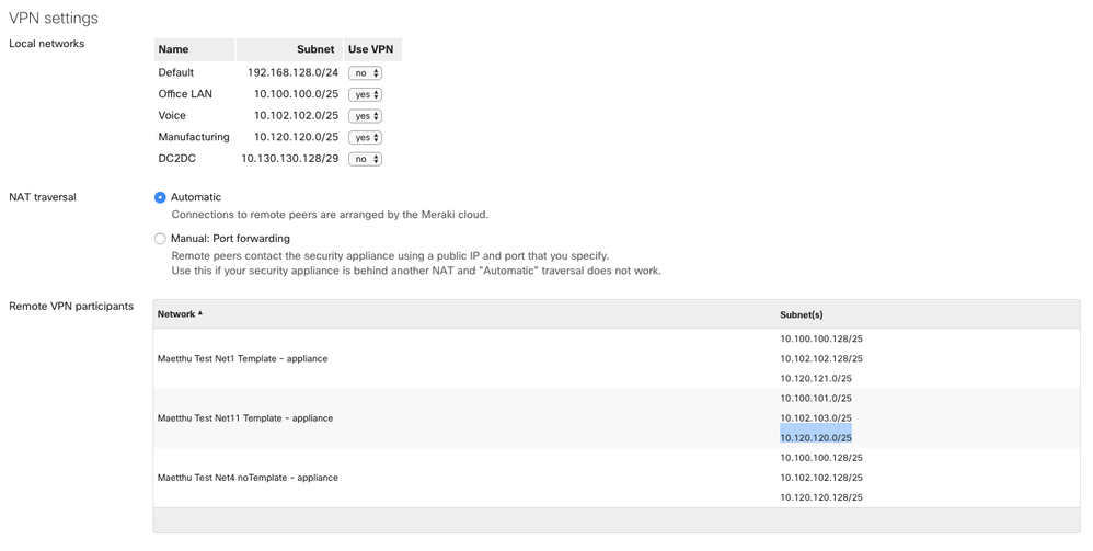

even though in some configuration situations I received error messages about overlapping IP subnets and I was not able to proceed I was able to configure my network in a way to have overlapping IP subnets. This was the case when I added a spoke site that used the pool of IP subnets out of the template. I do not know why the tests work when trying to add a hub site with overlapping IP addresses but not in the case where a spoke site gets an IP address out of the pool.
So I think that the best strategy is still to use non-overlapping address spaces for hub and spokes, but that was clear in the first place.
Thanks for taking the time for replying my (silly) questions.
Matthias

I have done further tests and I still can generate IP address overlaps. Just to make sure that I understand the concept of overlap checking in Meraki: Are the checks made per network bound to the same template (in which I define the uniqueness) or are the checks made based on the entire organization (all networks bound to a template and the ones that are not bound to a template)?
Thanks for reading and supporting people.
Mat
Re: Unique vs. Hub-and-Spoke
The checks are done when AutoVPN is enabled (so the template should be configured to be a spoke).  The subnet must be unique amongst all AutoVPN networks (or will be rejected).
Thanks Philip
That explains everything clearly and my tests prove that you're right.
Cheers
Mat
