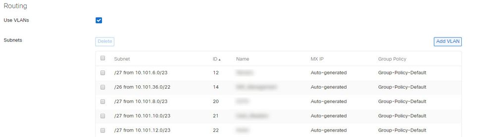

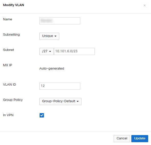

I have a Network Template to deploy some MX65 devices, we use 5 VLAN on each site, and i´ve choosed UNIQUE Subnets from a pool for each VLAN.
I notice that i was assigned same subnets on some of the MX65 that i deployed ... is not allways the same VLAN, it looks like random...

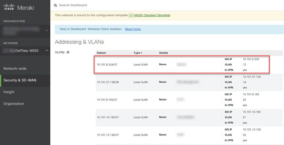

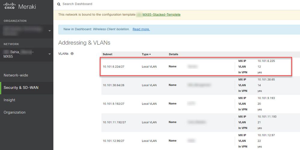

Yes, definitively ...
This is only one example, it happened randomly on other vlans and between different locations.
Example:
Network A
Network B
Addressing
Unique Selected
